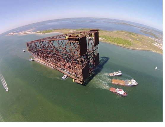

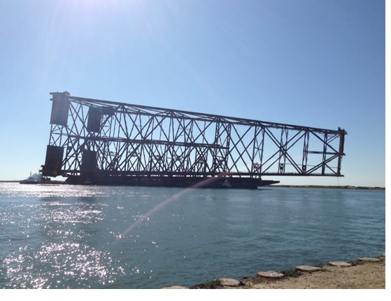

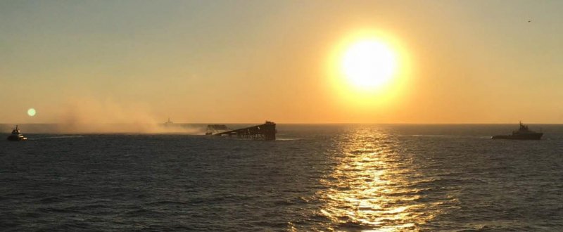

    [​IMG][​IMG]
    Jacket particulars:
    -Jacket weight: ~30k tonnes
    -Height: 371.1m, top: 14x46(m), base: 110x100 (m)
    -Skirt piles: 14 nos, 108" OD, length: 170 (m) each
    -Water depth: 362 (m)
    -Transport and launch barge: H-851
